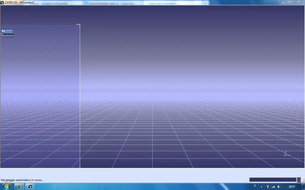

missing toolbar
  • Thread starter Thread starter quercia89
quercia89
Can someone tell me how I make the toolbar recompile?? as you can see from the attached image I can only use the command line. Thank you in advance! :Cattura.webp
Can someone tell me how I make the toolbar recompile?? as you can see from the attached image I can only use the command line. Thank you in advance! :View attachment 36245
igo image for toolbar restore procedure.
ps. I suggest you save your catsetting, so you don't lose your customizations
Hello victorious,
Meanwhile thank you for the answer. the problem is that I can go in nn tools as you can see from the image. I can only use the command line. I also tried to uninstall it and install it again but nn has changed nothing :). thanks again and good Sunday.
Hello victorious,
try to delete all the files that are in the path below specified
instead of????? you should find the name of your computer
c:\users\???? ? \appdata\roaming\dassaultsystemes\catsettings
