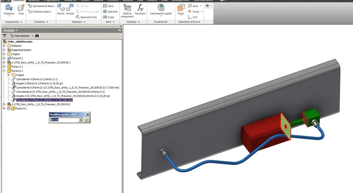

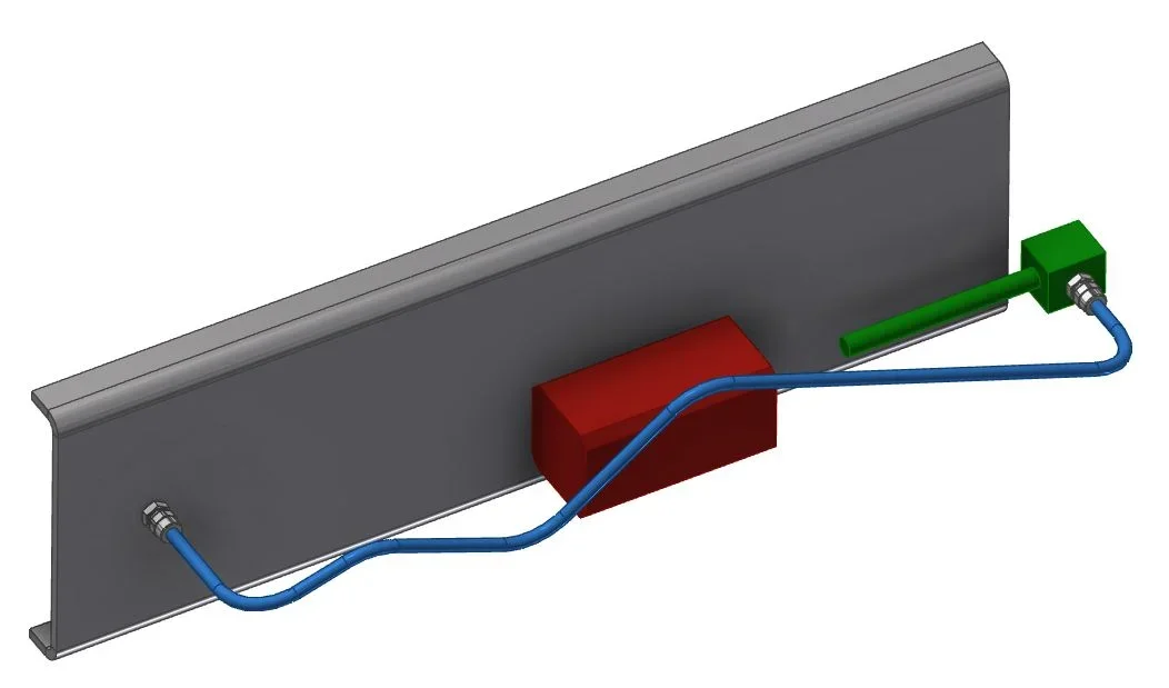

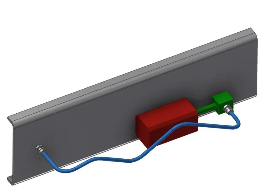

made a quick test just to show you:Adattivo-1.webpAdattivo-2.webpthe tube changes.
