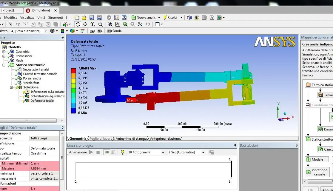

Hello everyone,
I performed a first static analysis on a robotized arm and as you see I have a deformed that I judge too high.I wanted to put a spring to counter the lowering.like the model with ansys?basta draw it on solidworks and insert the appropriate elastic module?

But no, what do you want to draw? !
you have some roads, for example:
1. use the "molla" available in ansys wb library
2. at the point where you intend to place the spring, impose an elastic bond with your stiffness value
cmq in the menu on the left, click on "structural static", in the toolbar at the top left (as mechanicalmg writes) click constraints. a spring should appear.
However I prefer to put a bond and impose hardness as I need, but they are two equal roads

Just draw it on solidworks and insert the appropriate elastic module?
This question makes me understand that experience in the fem sector is quite limited: I do not use ansys, but the advice I give you is to read the manual (or guide online) in depth, surely there is a way to introduce a "concentrated" rigidity with a spring type element. cannot be in the manual/guide!
