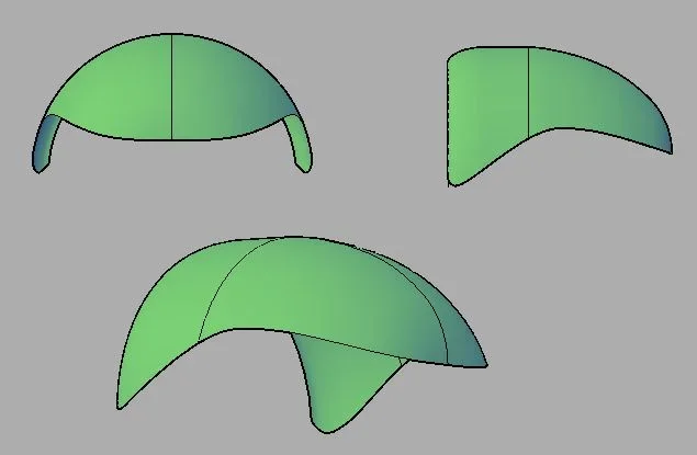

I need urgent to know if with autocad 2010 it is possible to create an object in 3d cable starting from these images in 2d.. is a somewhat complex form.

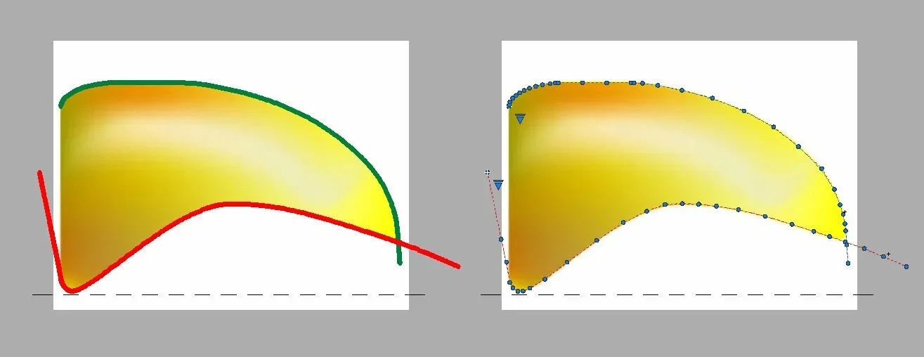

proves so, creates two splines, the green one serves for the revolution, the red one for the hairstyle, the black line dotted is the axis of revolution.
420.webpcommand revolution (revolves) to create the shell, then extrude the red spline, top and bottom, so that you completely overstep the shell.
421.webpfinally pulls the shell with option superficie (strude quella).
