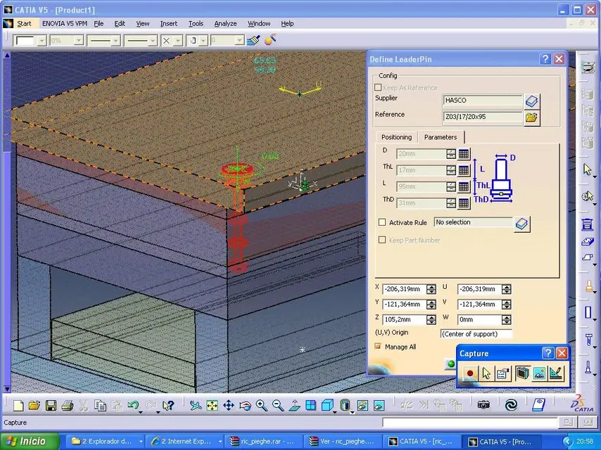

hi to all I wanted to know if when inserting components like columns and other, from the mold tooling design module, before inserting them you can edit the various diameters and lengths.
because the components of the catalogs that are present there (dme,etc..) do not have
exactly the size I need.
is a nice advantage to automatically trim the interested parts, inserting the components from the tooling design molding.
thanks early
no I mean that there are programs below catechism example toptron
that allow you when inserting the columns or guides in the mold
you can intervene and change the values of the diameters or lungehzze.
I don't think this catia can do it, and it's true that once it is inserted, it can be edited by changing the construction schetch.
for more clarifications envio image attached.
a greeting

You can
you position with the right mouse button on the gray window of the quota you want to change.. and eliminate the formula or association to the table .xls
hi victorious you can only change some measures for example for guides only in inner diameter and length, and for other measures?
So... cover the table .xls in your catpart and change everything you want
