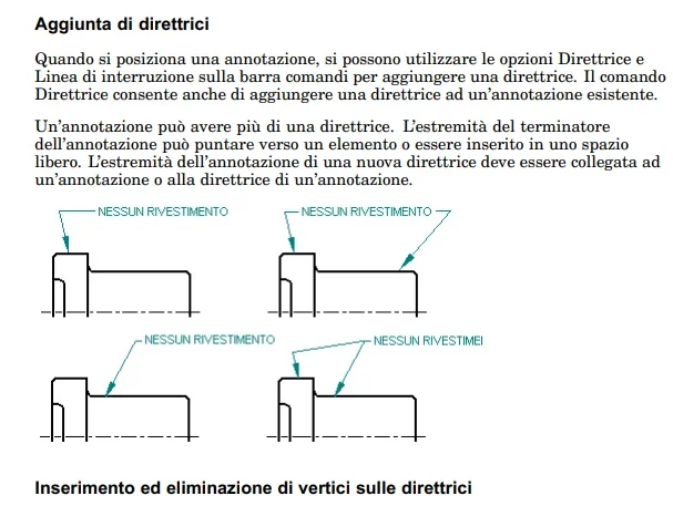

abro Guest Jan 12, 2024 #1 a quick help from the manual you just do not understand, How do you add more directions? Thank you.
Be_on_edge Guest Jan 12, 2024 #2 after placing the call with the main manager you have to use the command "director" to add a second (third, fourth... etc.)
