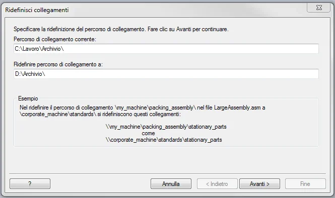

I currently have my archive in
c:\work\ archive\
while on the new machine I wanted a second disk to keep the data divided from the os, so the path will be
d:\ archive
Do I have to make any arrangements?
c:\work\ archive\
d:\ archive
in redefine links should I set the fields like this?View attachment 70683
for the first question, if you're lucky you don't have to do anything. solid edge (depending on how the linkmgm.txt file is set) usually solves the "fall" links from the first directory and then going deep. If all your files are in "archive" doesn't matter the level of nesting of this, the important thing is that there are no other solid edge files scattered around out of this directory and kids.

so I can copy my archive and try to open some together, if everything row smooth then I don't touch anything.
the linkmgmt.txt file has inside this:
container
relative
absolute
begin search path
end search path
Can I leave him like this?
