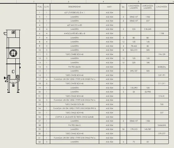

I have searched among the various discussions of the forum regarding the distinct cutting, and I have found nothing to the problem I found.
created a multi-body, consisting of sheets, structural elements and derived parts.
created its design, with inside the cut distinct set with the information I requested.
All right.
then for needs I had to create configurations where I went to erase some bodies, and from that moment
My separate cut was no longer what it was supposed to be.
I press that the separate cut I created it from the welded defaul view.
I was wondering if the mistake was mine, or simply it wasn't possible to create configurations without ruining the distinct cut.
I hope to have explained, and anyway I attach two pictures of the table before and after the configurations.

I have tried so much but always with the same result, I will remain
from here you should be able to manage all that of every configuration.
Let me know if you solved it!
Damn it! I thought I was remarried, but I didn't... cmq works on almost anything. if you right-click the "configure" option then you open the table. I do it on quotas, couplings, excluding/reactive, etc...
