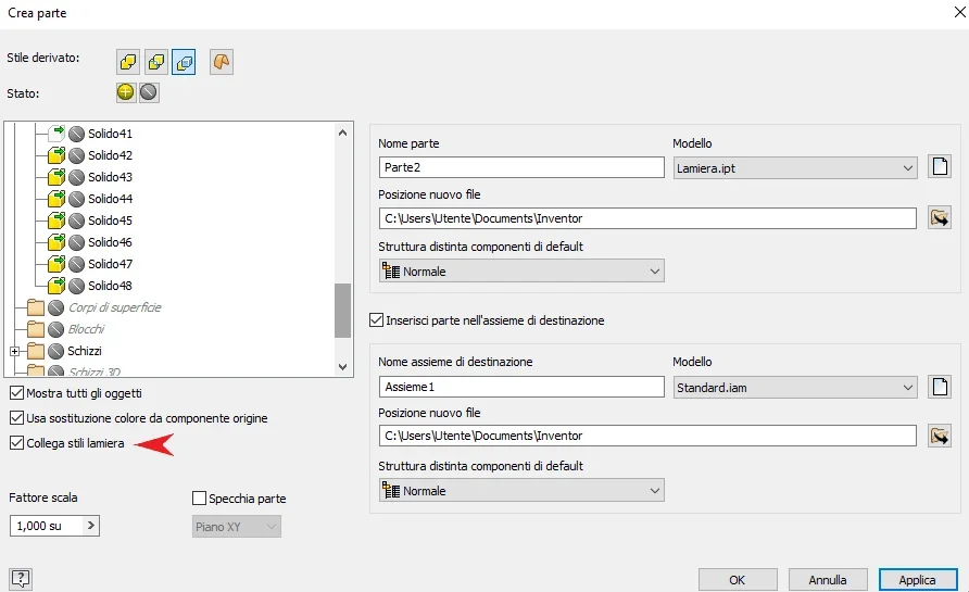

I have to network my answer, the thickness of the derived ipt can be unscrupulous from the father file by deselecting the option "connects sheet styles" both during creation and later using the "modified derivative part" command

when you create the part you have to remove the flag on "connect sheet styles", of course the part in question I created it with the functions "model 3d" (type extruded or thick) and not "sheet" (type creates face).CREAPARTE.webp
