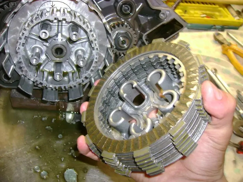

hello to all, I built with solid edge a drum clutch, (this http://www.crosshop.eu/img_export/prodotti/px18.1290.jpg Sorry for the resolution, but I didn't find any more photos, to enlarge just click ctrl and with the zoomed wheel) I did everything but I have a problem, in the crown where there are those "nervatures" there is a excavation that I don't know how to do. .
Would you give me some advice?
put the image with an arrow or something that indicates the dig. from the image there are many ribs and excavations and you do not understand
I have attached pictures where you see better
I hope you understand now.. .
thanks to all
ps. I forgot, I would also have another request... how can I draw an internal detachment in a hole (from the first photo you see what I mean)?

Okay now you understand. to do this you must use the sliding cut. define the initial sketch of the v opening, then do a sketch of the final v opening (the narrowest) and then a sketch of a segment that goes from the first to the second. with the command sliding cut the path, then the initial and final sketch and makes you the cut as you want.
if you look at the tutorials find the drill of the slider. The dig is the same thing.
I can't open the annex because I use v16 version, but now I try both procedures, but I don't understand how to do the sketch... how do I define the plan I have to work on? In theory to create a sketch I should create a curved plan that follows the course of the outer crown.
mmmm recttifico :d I managed but in another way, I forgot the possibility to create a plan with the 3 points, so I created the plan, created the sketch and made a simple excavation, then I picked up the various angles, now if I wanted to copy my excavation on all the ribs how can I do?
