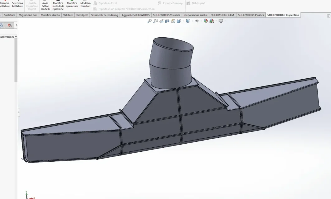

Hello everyone,
in the table setting on a flat breakdown, this error message appears to me: multiple bodies not supported for this function.
in the flattening sheet metal model works quietly, you know how to give me an explanation on the question?
as always I thank in advance all for the answers possible dates.
place the 3d model to better understand what to do.

I didn't do the model, I just have to make the table, I was provided by the client, and it's part of an overall, I extrapolated it to be able to load it here, now I try as you say and I'll take you.
for proper management the development configuration should be created exclusively through the insertion of the view with the repetition check flattened in the design environment.
you are in fact massive right, I do so in fact, but this model has been made in a multibody system, it has given me not few problems frankly, lastly this flat breakdown, I had to extrapolate the incriminated sheet because also proceeding as explained by new rider in the base model did not work, it seems to be a double breakdown instead of what would serve me.
if it is a multibody, as I wrote previously, you have to do body selection and then you can do flattened view
in fact for all other parts I did so, but that in particular does not find its flat breakdown, sw tries to load and plant me the pc. the part is made very strangely frankly. It is a mixture of solids in sheet metal and sheets made in a special environment, however this is.. and I have to boil the same.. .
nb: if only that part is extrapolated, the distribution miraculously is n°7 as it says new rider.
I don't have 2018, if I could update the profile would be appreciated, I can't study it to understand where the problem is
I'm sorry if there was a way to turn it into the vers, 2017 I would send it to you, but I don't know exactly how.
