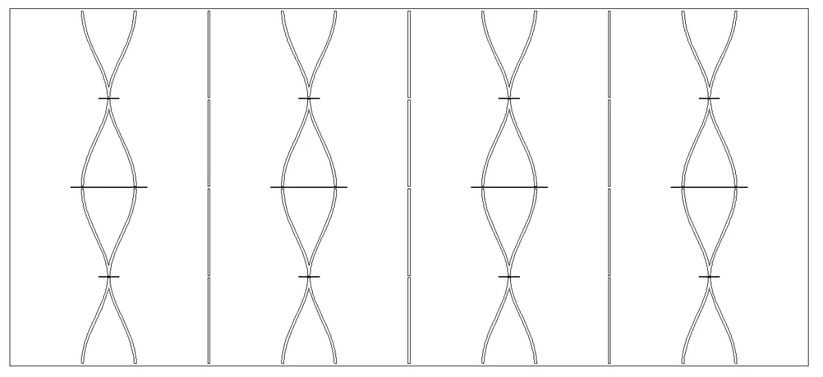

I happen to prepare cutting files on multiple sheet in dxf format.
the case that I want to expose you today is a development of pipe grafting bushing.
I would like to understand whether from a development such as the following:
1711003679042.webpfrom this development I would like to try to obtain as automatically as possible this:
1711003730215.webpaccording to you it is feasible to do it on whether or it should reason on dxf file
hi, there is a form (paying) for solid edge that is called 2d nesting and it serves precisely for these things.
if instead your part is always with this form and change only the reasonable measures on creating a highly parameterized part.
thanks as always very kind.
probably you can also do with a parametric but I have to figure out how to handle that curve, the known points remain two odds but I have to think about doing tests.
I would be right about the finished piece, development and nesting are consequences
