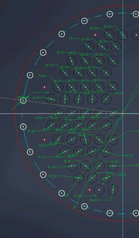

I find myself changing a series of holes from one diameter to another.
I did not find a function that allows me to change the diameter of the selected holes.
a kind of quick selection of autocads.
Cattura.webpThank you.
if you are on catia v5 check if the holes were made with the matrix. If you, changing the first should change them all.
from the image you seem to be in the sketch environment (I imagine, but you could also add it).
I see you made a circle of diameter 31 and many other circles that recall the first.
did you then extrude in modalita size? That's not what a hole does.
However if you have done so now select all the odds you want to change and give the new input.
I know that the procedure is not correct.
I made a glue copy of the autocad sketch.
I could do it in the change of diameter, but is there a similar function in inventor?
to do it first now you double it.... the function in sketch you ask after a paste copy does not exist that I know.
Excuse me, something escapes me, I see that you have all the listed and connected diameters (fx:31), but if you change the parent quota (where the fx:31) does not change everything in one shot?
