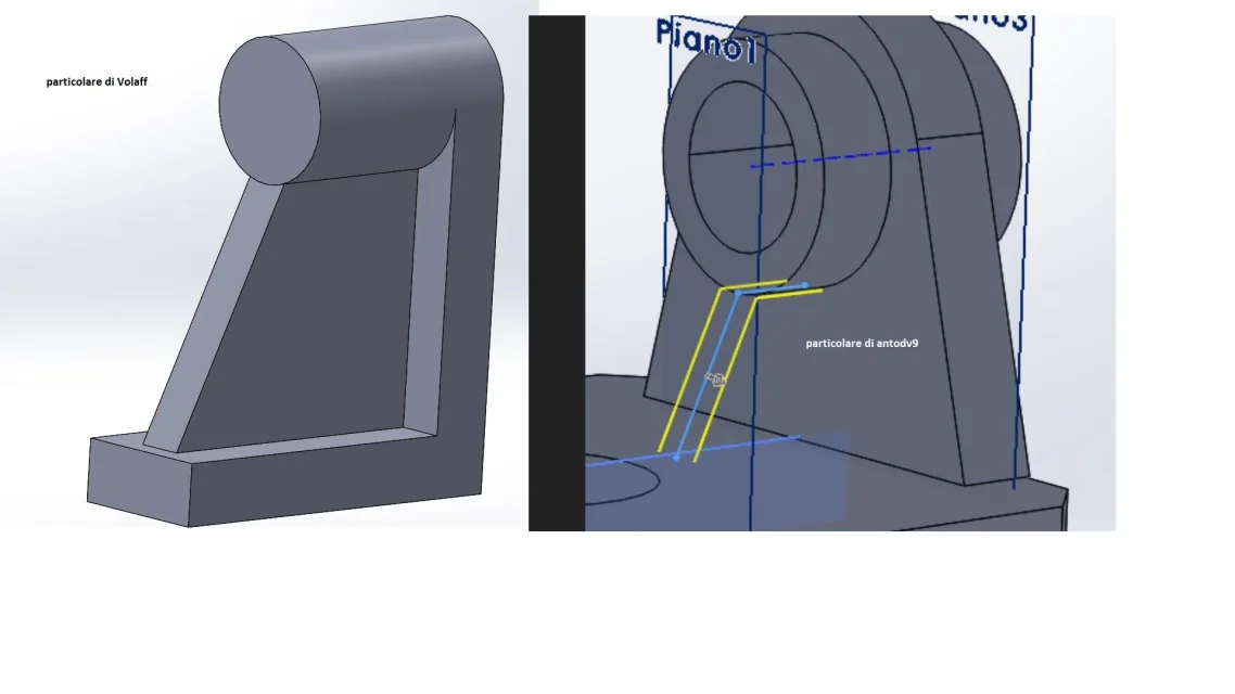

you say it gives you a mistake, but what do we know about it if you don't write it and in the images you don't put the feature manager with the settings you entered and the error message? we are not wizards even though sometimes it may seem
I don't think it's a tangency problem, so that the diagonal could be enough to make the rib (see volaff file).
I also thought of a tangency error, would you be so kind to me just that part of the piece?
the error is the following, the rib does not intersect the existing model.
Of course, I actually know how to make a rib in that situation, however I have difficulty in making it from a cylinder to a flat surface as in my case.
in the image there are the two files, your and your... What's the difference?Immagine.webp
However if you look good on the forum you will find a .avi file created by mike1967 in which it exposes all problems and solutions regarding the rib.
Now I don't remember the exact topic.
in reality you can make that rib even with that species of l as you did you just give a very small length to the horizontal tract or even realize a simple extrusion
Is it made with solidworks? Let me be puzzled
to make a rib, which is nothing but a body that stiffens to which a specific name is given, there are many ways., but I have assumed that who I put the question wanted to do it with the special nervation function that can not be done with that sketch (i.e. with the tilted line and the tangent line) and in that case can not be done if the part is multibody.
certainly when the user specifies that:
I know how to make a rib in that situation, however I have difficulty in making it from a cylinder to a flat surface as in my case.

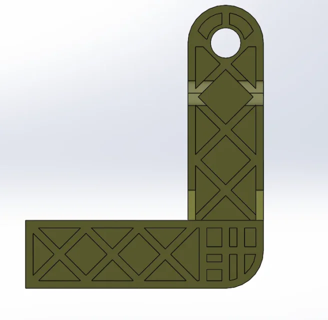

good morning to all, excuse the question but if I have a piece with all ribs (among other things different) usually which is the most suitable road for the correct quotation at table?
Thank you all.
They are stiffening ribs, so you don't need precision. being evident that they are all of equal thickness I would quota the step, the angle and the thickness. this for the vertical x zone and the same for the horizontal one.
instead for the zone with the ray quoti a thickness and a method between quotating the spaces or the hypothetical half series
