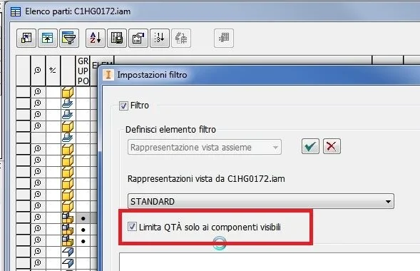

in addition to the many news of the 2017 version published in the various sites cad, youtube and facebook, I would like to point out to you this important news a little “hidden”
often you have the case of having assemblies of groups with different “configurations” or solutions
the problem of this solution, is that during table 2d, all parts / assemblies are counted (although off through the representations of view); example:
in the axieme I have 2 brackets to carry out a simulation or configuration, I turn out one but in separate they still appear 2 in the qnt column.
therefore different solutions are adopted, if possible representation of position, or you refer one of the two brackets (think that I work if there are more parts to “hide”) or, when you are in a hurry you manually change the qnt in the separate table 2d (with risk of errors in future changes)
finally in 2017 version added an option in the view representation filter together
