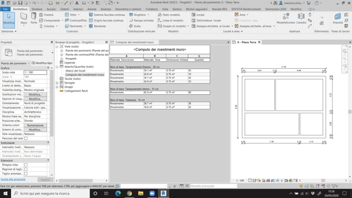

I simply added the parameter "material: area", a column called "unitarian dimension" (in which I would have liked to insert the size) and a column that I called "quantity" created with fx that should have divided the area of the coating for the parameter "unitarian dimension".
That's exactly what I want to do. I'm definitely doing something wrong but I don't know what! How did you insert the column "unitary dimension"?
I can't really understand. I entered the parameter as shown below. notice of differences with the insertion of yours?Immagine1.webp
Why generic models? There's something wrong with me on that screen. I do not see the category of walls for example. . .
I don't know how to thank you! I found the mistake. If I create a compute "multicategoria" I can't enter my parameter in the "muro" category and it doesn't let me insert the values. if, instead, I create the compute by selecting directly the category "muro" works all. Thank you so much!
