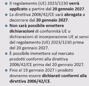

to me it turns out slightly different (maybe I'm wrong), that is that you can apply the 2023/1230 already from now (also on a machine marketed before 2027) but it is optional, a free choice; from 2027 instead it becomes mandatory.
I also have certification software for certification and for a few months it allows to choose for any project if to apply machine directive or ue regulation.
Article 51
repeal
2. Directive 2006/42/ce shall be repealed on 20 January 2027.
Article 54
entry into force and application
This Regulation shall enter into force on the twentieth day following its publication in the Official Journal of the European Union.
it applies from 20 January 2027.
It seems to me quite obvious that until 19 January 2027 the directive applies, then the regulation.
It is obvious that if you have to design a plant that you think you will enter into the market after 20 January 2027 you will have to design it according to the regulation.
the Regulation entered into force and some articles are already applied or will be applied during 2024 (Article 54).
On the question of the declaration of conformity according to the Regulation or Directive, yesterday at a conference the issue of the declaration was discussed in accordance with the regulation or not before 20/01/27. you can also make the statement according to the regulation but it is one more: you must however comply with the res of 2006/42/ce and mark according to 2006/42/ce.
if you want to go further, you can do it but the obligation is for 2006/42/ce.
