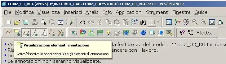

Good evening, boys!
apologize if I still disturb another, simple (for those who know well proe) question. inside a part or a set how do I make the holes created during the modeling appear/discover from the base window?I refer to the words: m20x1 iso, etc

there is the button:-), see attached image.
of course the holes you have to have them with the hole function, if you made them with an extrusion cut you do not see a blessed.... .

I can't find the icon you described. in the bar above there is not and in the menus that allow to customize the bar even. I have seen in the menu customize to the item view.
possible? Proe version is 3.0
edit: there is the cloud icon with arrow, i.e. the feature anotation, but I do not find that newlet with arrow and eye symbolizing the display.
I think it's weird that it's not in the controls.
did you right click on the >comandi toolbar?
> displays and then I looked for the image icon you post. nothing, there is the display icon of plans, points, axes, but note nothing.
Boh. .
Thanks anyway for your availability! :finger:

use layers, create a new level called notes, and there positions all the notes of the model.
once you do this, hide the level and save the display status.

I would not use the levels for the notes of the holes captions, in the structure of the hole model tree you can simply turn them off, or set the key:
model_note_display on no, they only bothered me.
In the table you can still call back. :smile:
