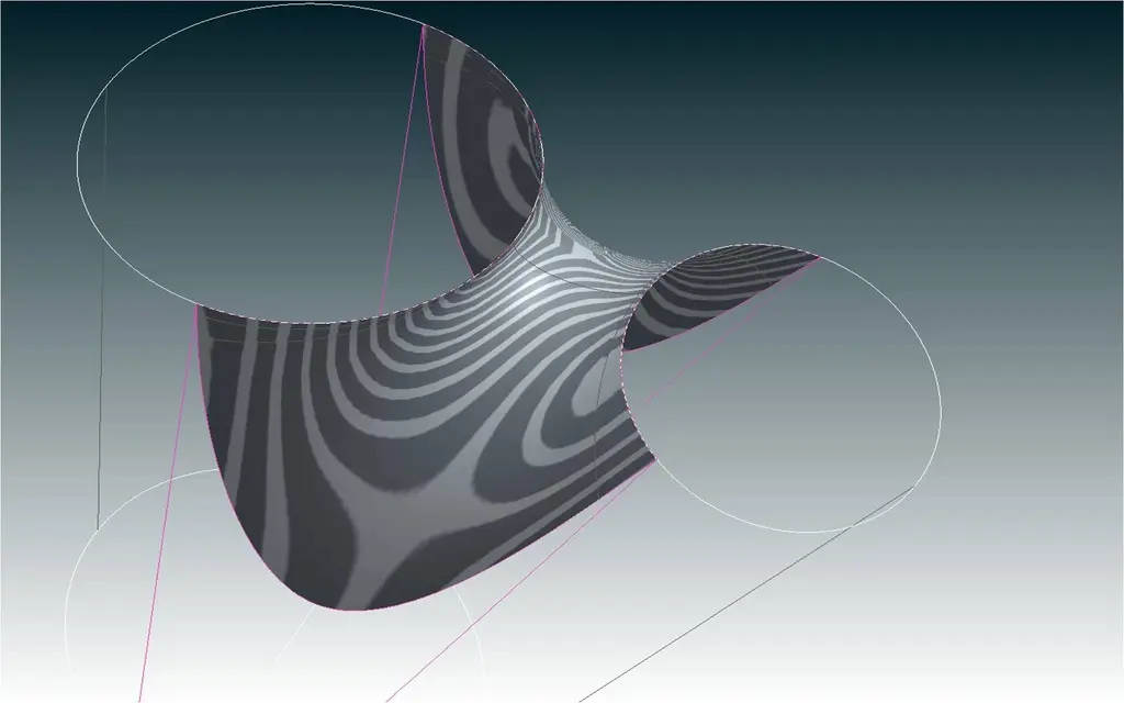

I have a problem with the feat 51
as you see me it does but to dx you notice a deformation that for how it was all built in symmetry should not be
I have solved patches other way etc but I remain doubtful why this happens
wf
wf
Hello, mamo.
do it in 2 pieces, giving it the normal on the central curve.
surf.webpgreetings
as usual always accurate
but I have tried as you say my feat 51 (your is 52) and I get this result, where am I wrong?, it seems to me to do your same procedure.
Thanks again

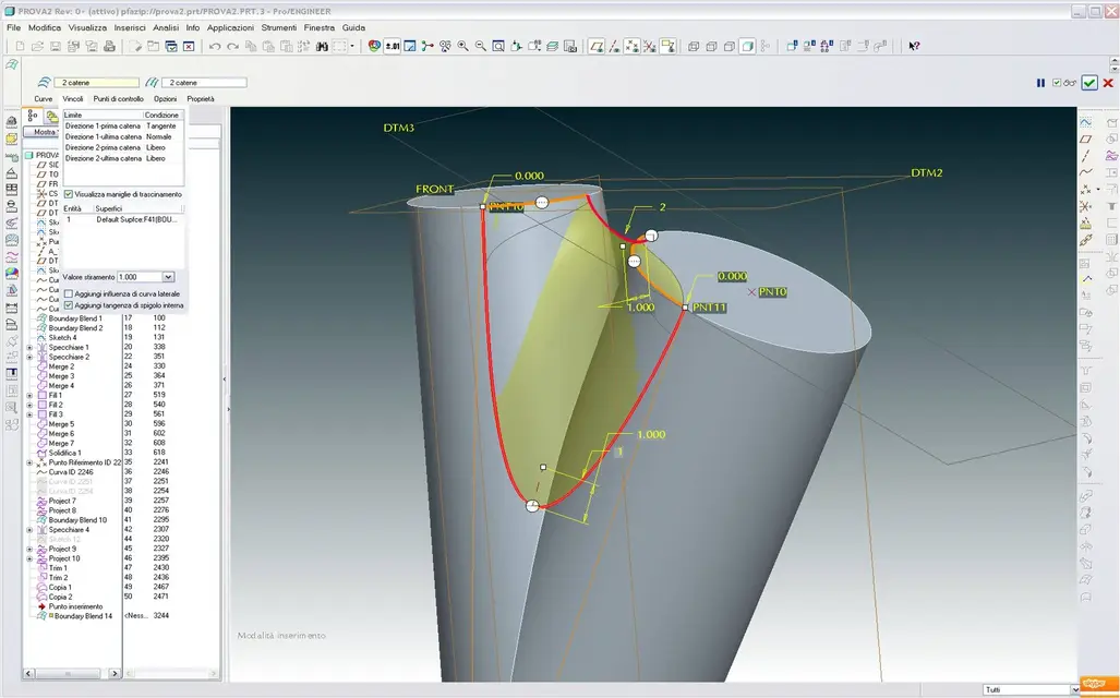

enter the bound tab as from image/flag on display drag handles, you will notice that the handle is activated with the value 1.00, bring it to 0.1 and the game is done. :wink:
you must have patience
apart from that in your feat you know that the value was 1 , when I make this change the situation worsens

not the value of ironing... That's right.
you have not put the flag on display drag handles, look at the last jpg attachment of the previous post.
At that point in the graphic window you will see the value you can drag, that you have to bring it to 0.1.
I don't have almost hair anymore because with time to take space the halo. :wink:
done.:finger:
