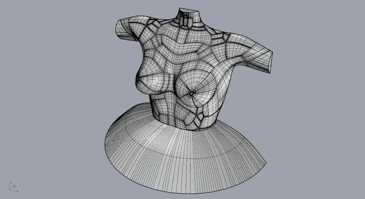

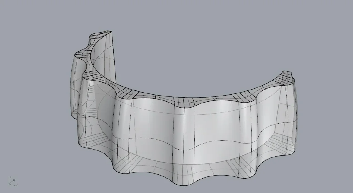

as the object are taking the stage exams.... of my daughter!
should make a model of his idea for which 2 pieces are not available with "home" techniques and for which we have made 2 models in rhino to evaluate the realization with numerical control milling or even with any other technique that cad3d experts will want to suggest.
It's obviously an aesthetic model. I suggested the milling of a block of polystyrene, polystyrene or something similar, painted.
or you could also think of stereolitography assuming that both pieces have a thickness of a few millimeters (and are therefore cables).

(I attach 2 rhino files of objects to be made)

You're right, there they are.
if someone needs a different format (exportable from rhino) let me know.
