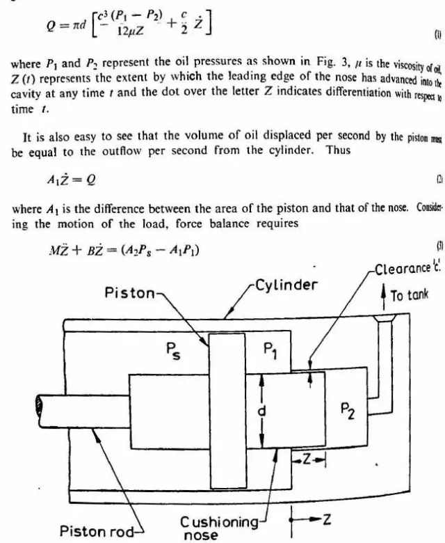

I have to design a braking system for a hydraulic cylinder with this principle:
- before arriving at the end-race the cylinder passes in front of the hole of the oil mouth, in fact choking it
- while the hole is rubbed, the oil comes out through a meato (clearence or gap) between the piston and inner diameter of the cylinder
- the fall of delta p determines how slow the race
given to large lines the principle with which I want to perform braking, I must determine the size of the oil passage meate
during the hole chopping.
this meato (or clearance) is derived from a formula that I found on a treaty of an Indian professor
Capture.webptrivially, by doing the reverse formula you could get c, but unfortunately I do not have any other notions so deep of algebra
to solve the formula.
I ask anyone who has knowledge/experiences about it if I can help.

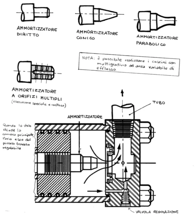

I would say that apart from finding formulas without knowing what's behind it can be more harmful than useful, I would say that first you have to understand that a hydraulic brake of damping works because you force the oil to pass in a small hole at reduced reach where the pressure rises, there are high load losses, and then the oil comes out little at a time making it slow down.
the shutter profile made as extension of the stem changes the way to slow down more or less gently.
Moreover the adjustment screw manages the fine adjustment of the oil flow in braking and therefore increases or decreases the damping time.
but buying a hydraulic cylinder already made and dimensioned by a serious manufacturer does not agree?
I'll train you some notes where to think.
we are talking about 13 l/min to be downloaded from the rear chamber at speeds of 70 mm/s to brake to a tenth of the speed i.e. to 7 mm/s with capacity about 1 l/min I would say that by making the account of the servant you will have to have a 2 mm hole adjustable screw.

Moreover the technique attached to you to make braking with diameter of the shutter poor compared to the hole, not regulated by screw is a bad system for the management of a braking especially if the braking mass is high.

said this, and I repeat, as a true profane in the matter, probably a braking with "nasino" is better than the piston passing in front of the hole and strozza. As soon as I align myself with the different works, I will try to study what you posted to me and in case I will bother you with some questions (in case I thank you in advance).

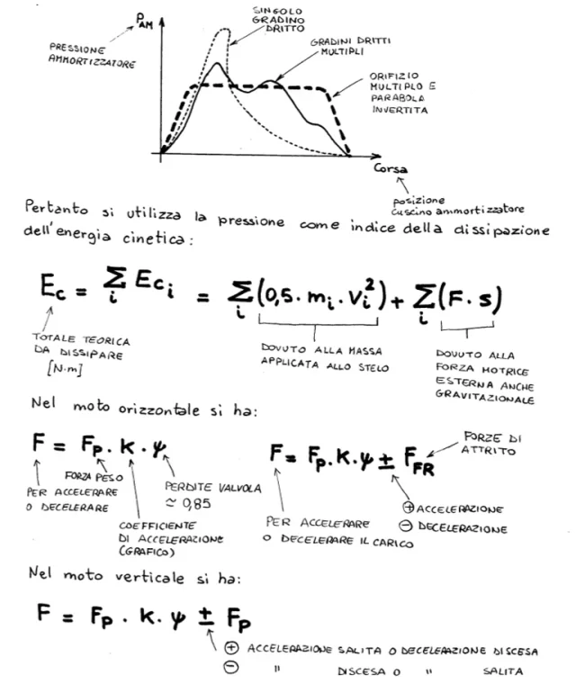

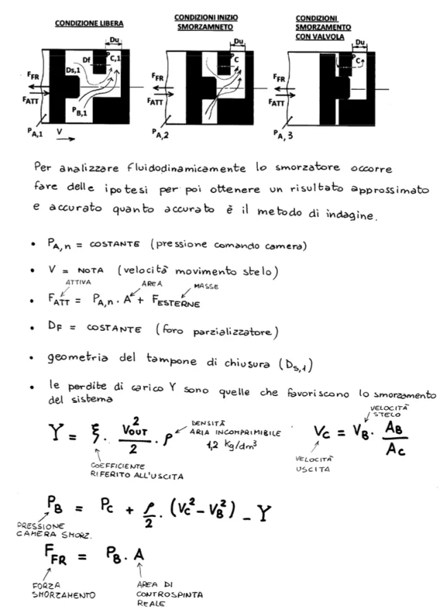

If you try to look at the atos catalog there are formulas related to decelerations and there is the speech of mass and kinetic energy to be dissipated. you will find the design on a tilted plane that shows you in synthesis the concept. If you don't know how the application is made you can hardly measure it right...then without adjustment you have no margin of error and you'll have to do some test at the counter with a similar cylinder.
