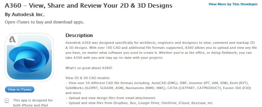

hello to all, as from title I ask if any of you opens the inventor files on smartphone. How are you doing?
a year ago I did some tests with inventor publisher 2016 and it worked, you have to upload the project to publisher and after from an android app, but I think there is also for ios, you could see the project and do also a presentation.
Now I don't remember all the steps I've done but it all worked, of course the project had to reside in cloud a360 .
if not mistaken from the app you could also open ipt or axiemi placed on the a360 test should work.
Yes, I did, but... if not erro, publisher viewer manages presentations and not individual .ipt or .iam files
I didn't try it, but by reading the email I previously published, it opens all the iv files
