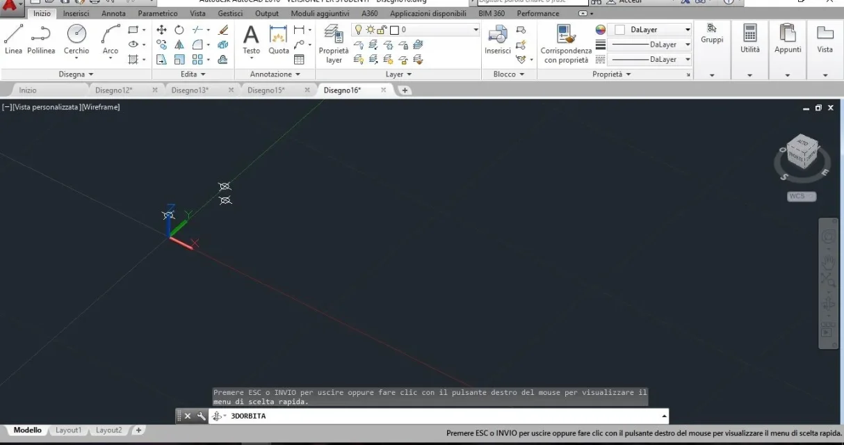

I'm new to the forum and especially the cad programs, so I don't even know if I'm in the right section and I'm sorry. I need your help if possible. as seen from the image, I have points and as you can see the cross of points is oriented according to the x axes and y. how do I rotate it so as to have it along x and z?

the representation of the points depends on the uct in use at the time of their insertion.
Thank you very much! Unfortunately I had already tried to create my ucs but I always have the drawing plan on x,y. I don't know why he doesn't move it to me.
proof questo lisp...
