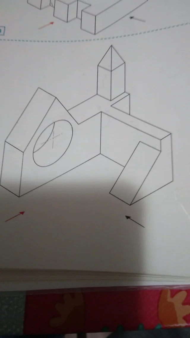

Could someone show me how to perform the orthogonal projections of this solid?

Put your solid in a transparent cube and put yourself in front of each face and draw what you see on the floor of the cube face.

first of all determine what must be the main view, which is the opposite view or prospectus:
I would choose the view according to the arrow at the bottom right.
looking then from the top and left, draw the other two main views: plant and right side.
if these three views are not enough to show all the details of the piece, add other views or even sections.
the views must be placed according to the European system.

jokes aside, as they have already told you, put your first solution, then we discuss it and proceed, learning. Next time you're gonna have to cuff her.
