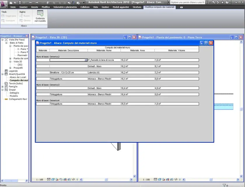

see the abacus of the compute of materials

for the second question I meant that the component layers could be displayed so that they could change the priority in a table and not have to enter the properties of the type of wall used. I tried from the abacus of the compute of the wall materials but I do not find the possibility to insert the column "function".
