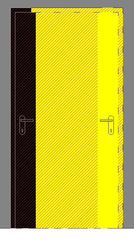

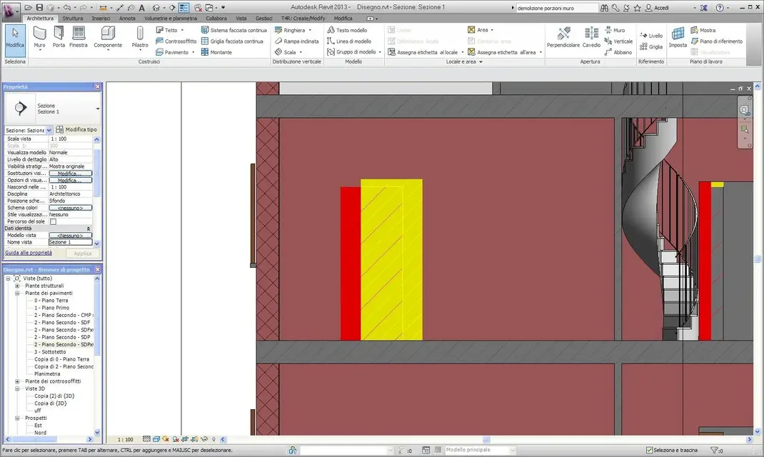

Hello everyone, I tried to look for a successful discussion.
how do you solve a problem of representation of this type, an opening (door or similar) that partially overlaps with the existing opening in the state of fact?
I attach hidden online image and in shaded.
thanks in advance for considerations and advice.

Hi, two things:
- can not set a display that does not sample the area that intersect demolitions and new construction? I'd say no... true.
- to what extent does the contour of the door refer to? I would like to make it visible in the representation of demolished or new construction.
I hope to be explained, and I thank you for the always useful advice of the forum.
