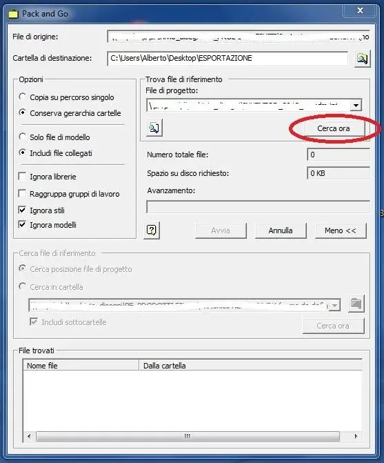

look in the attached pictures, "first phase" click "look for now" at the top and find all 3d of the affected axieme.

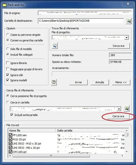

then in "second phase" you pick up "search now" down and look for all the other files connected to the 3d previously found.
at this point, by clicking the second "try now", you start the search that lasts days.... is it normal? ?
