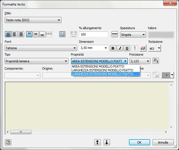

I would be grateful if you could give me some indication or suggestion to manage the variable containing the length of the sheet metal part explained.
I checked between the parameters and the latter is not among the available.
in particular I need to insert this information into the cartiglio and I would like to avoid writing it personally from time to time ..
simply insert the sheet metal property into the cartiglio - flat model length or width depending on what you use, see the attached image
