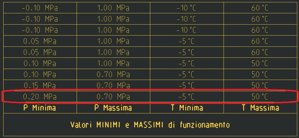

in each part I have created the parameters p_min , p_max , t_min , t_max as real numbers to which I associated the values of pressure and operating temperature1594372784148.pngwhat I would like is to determine the values of the same parameters of the axieme with these conditions:
maximum value of p_min (in image 0.20)
minimum p_max value (0.70)
maximum value of t_min (-5)
minimum value of t_max (50)
on the drawing I managed with a table with four distinct repeating regions ordered in an increasing/degressive way, the values that interest me are on the first line below, but I would like to be able to see these values on the 3d1594372956435.pngIt is also clear that the main axieme on which I am interested is multi-level, so with sub-axis
