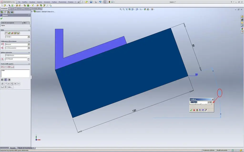

we say that I have a part that changes inclination through an angle.
to the face of this part there is a "l" (I call it so to understand) coupled as a coincidence, whose angle at 90° between the "|" and the "_" (vertical and horizontal listarella of l) I would like to change the angle of the first part (always keeping the vertical part true).
as I do now, of course, at the change of the corner changes all the orientation of the "l" and does not "deform" the angle between vert. and horizontal...
I explained... I didn't understand much!!!!:angry:
Well, if you need an image, I'll do it!
Mar
Here's the picture!
to change the angle of part 1, even the angle of part 2 must change in the same way but keeping the vertical part always vertical!
Thank you so much!
Mar
Here's the picture!
Thank you so much!
Mar
you can do so by inserting an eqution with equality between the odds that interest you, or together, depending on how it is built, you can work on the constraints of the sketch that generates the "l".
depends on how you shaped it and assembled it, but the ways can be different

look if one of the ways can be this.. and especially if I understood what you ask:ANGOLO 1.webpANGOLO 2.webpView attachment PROVE ANGOLI.zipgreetings

if in a set with part 1, I create a new part (directly in the axieme with "insert new part"), I can very well.
If I create the two separate parts and then I assemble them in the axieme, instead I can't!! !
of the two parts, ignite the faces as you did in the pictures but at the varying of the inclination, tilts all part 2 and does not change the angle as I would like.. .
I obviously mistake something in the couple, since with the coupling on the spot, instead it works!! !

the coupling "on the place" centers little or nothing, the difference does it as drawings the sketch of the l.
If in the axieme you go in contextual modification of the part whose face must remain vertical and on that side of the sketch a parallelism to a vertical plane will solve the problem equally. the difference between the two systems is that in one case you know what you do, you manage the couplings, etc..., in the other you rely more on swx, which decides where to put the origin, etc...
keep in mind that such an approciation is disastrous because faces are quite unstable in case of change.

That's right!
just set the sketch of part 2 so that it is tied correctly to the important edges of part 1...
