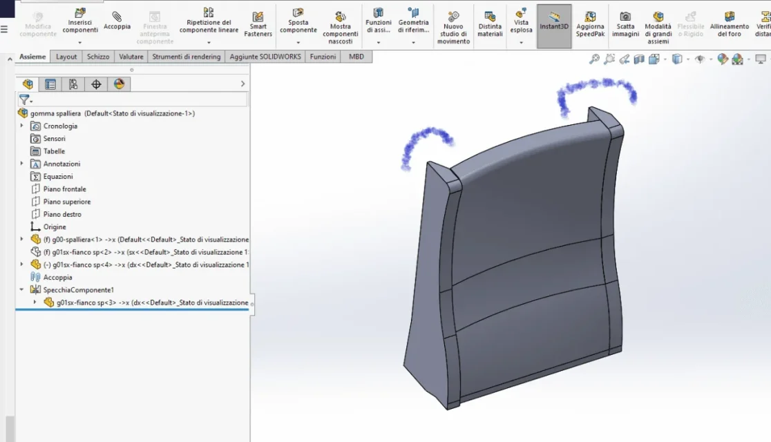

I ask for your help to better understand in the environment together, the component mirror function - opposite hand creation - new configuration derived in existing files :
reference to the g01sx-fianco sp. ,
both in the environment part and environment together, when I go to click on the derived configuration generated by the composite mirror function,
the part is displayed in a different position than it was mirrored (on the right hand side opposite). I don't understand why because the initial mirror is correct

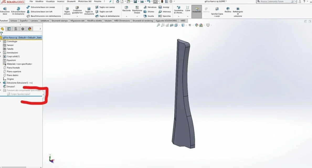

in the part the function that generates the opposite hand version is suspended. in fact the active configuration is default
The function that generates the opposite hand version is suspended. in fact the active configuration is default
if the active part is displayed in incorrect position (as you see in screenschot 44)
as "the mirror" was done on the right floor
in the axieme the blue part has the dx configuration, the mirrored part can not see what configuration it has.
the part of screenshot 45 is set in default configuration which is exactly speculating to that of the blue part of the axieme

][/QUOTE]each part is placed on the propia configuration, (see figure 47) I don't understand why if they select the other configuration the part is displayed as in figure 44, I would have expected to see the parts as in figure 48(I have specially copied and placed the part to make the idea)

the opposite hand mirror creates a geometrically specular version; in figure 48 is not so because it is only about mirroring the position regarding a floor

in Figure 47 you have the same part with sx and dx configuration, in Figure 44, of the first post, the parts are equal therefore must have the same configuration.
What's bothering you?
I point out that the axieme you attached shows, as from the image of my post #5, already the correct position of the parts as from your image 47 and that one has the configuration default e l'altra while in your images sx e dx.
I am tormented by the fact that I do not see the piece in the position I have created in component mirror, when I go to activate the derived configuration
I don't think this is a problem, but the fact is that I don't know how to explain why the derived configuration doesn't show me in the piece as it was mirrored.
so to better understand how solidworks works
As I wrote to you, I opened your set and it was all right.
in the image of the first post the blue piece is equal to the gray one therefore from the idea of being in the correct position but with the configuration, that you do not see why the mirroring function is closed, wrong
