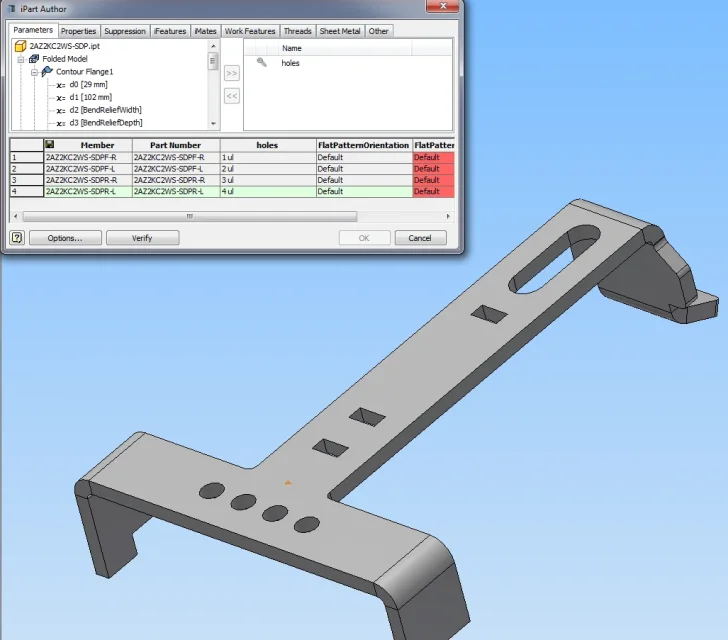

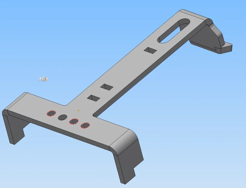

My part is this:A.webpthe holes highlighted will be from 1 to 4.
I know they want to change it after bent because they told me to try. . .
I did with iparts, connected the variable with nr. of the pattern of the holes.
So I had lunch with iparts.B.webpI know him.
I don't understand first.
Do I have to look for buds to make a derived part?

My part is this:View attachment 39719the holes highlighted will be from 1 to 4.
So I had lunch with iparts.View attachment 39720I know him.
