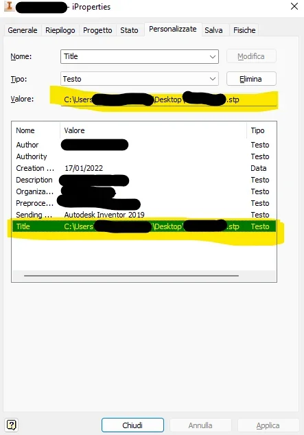

I noticed that if I receive a .stp file, going to the "personalized" section of "iproperties", under the name "title" I find the path where the person who sent me the file had saved it before sending.
At cascade I doubt that the people I send my files to, doing the same path can see the path where I saved my file before sending it (what I would like to avoid).
Can you tell me if there's a chance to "discount" this information?
Thank you so much!! ! !

I don't think there is an option to disable field compilation with file path when exporting to .stp
However at the end a .stp is a trivial text file and the properties you see are written in the first rows of each file, between single quotes.
just open the file with the note block and write 'pippo' (or 'pluto' or 'paper', at your choice... ) in the properties you want to edit and that will see who converts your file.

Thank you very much for the information. I had not thought about the possibility of opening the file with note block.
changing it from there the information is no longer available, so in line with my need.
