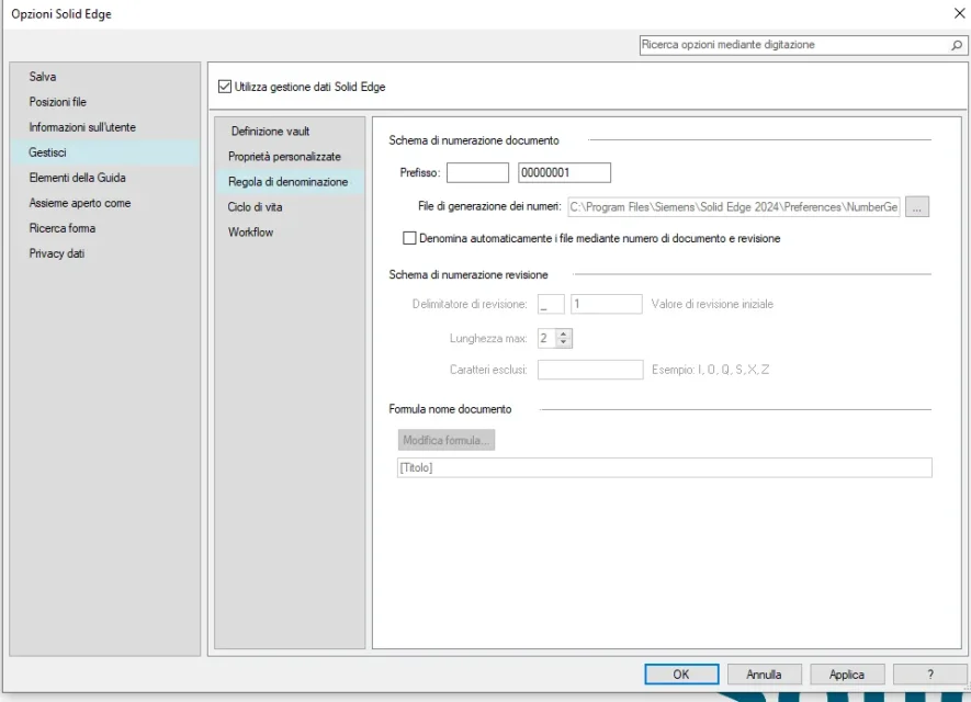

good morning to all, a curiosity: can you see in the pathfinder (which in version 2024 is no longer transparent but matte) in document number instead of the file name? because, in my case, I usually use as file name a version of the abbreviated title, as usage, as "official" data, the properties in the file "number document" and "title" (which appear in the various separate documents).
I wondered if there was a possibility to customize the pathfinder so that it would go fishing the property of the file, rather than recalling the name of the file, since then, if I had to look for a certain part using pathfinder, I would look for it through "number document".
I hope it is clear, thank you and good work to all.
disability
appears in the pathfinder but when I save files it does not really insert the affected property into the name, can you do it?
I don't know if that's the right answer, but you have to activate the option in "manage"
