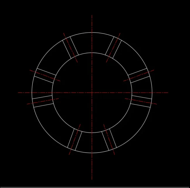

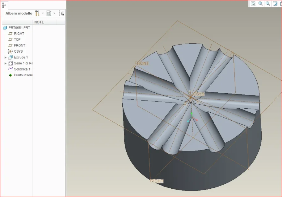

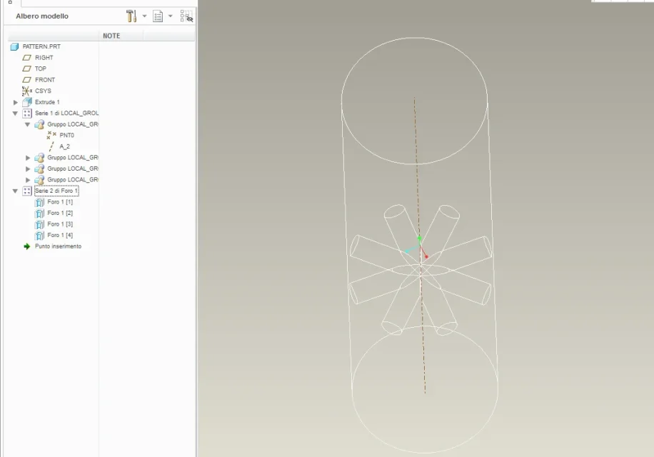

as from title I wanted to know if there was the possibility with pro-e wf5 or with creo-3 to create a pattern of holes with different angles on a cylindrical surface.
I tried to do the following:
- sketch with geometric points placed on the top of the cylinder at the desired angles;
- passing axis for a point and normal to the sup. of the cylinder;
- hole on the sup. centered on the axis;
- pattern point
the problem is that when I go to perform the pattern all the holes in the series come with axis parallel to that of the first hole and not normal to the surface of the cylinder as it should be; it is as if the axes of the series remained normal to the sup at the first point and not at the point through which they pass.
