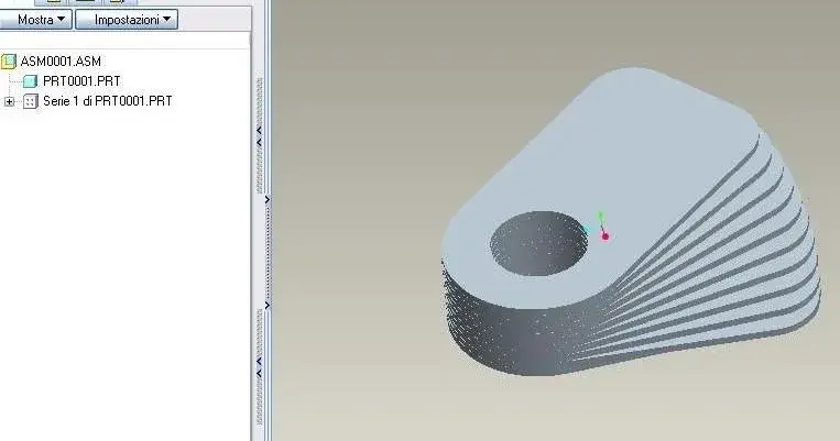

Does anyone know how to make a pattern on axis with a rotation of the particular on the same axis?
I want to build a rotor in assembly, to assemble all the sheet pack I have to perform a pattern but it is necessary that the rolled sheet of a certain angle.
Thank you for your help.
I did a very quick test.
then insert the first component a. fix it, whip again the component to using the axis for example to align it, the right and front planes to establish the angle between the first and second component and finally select the 2 back faces, connect them using the offset to make sure they are one above the other as you want.
at this point command series using the second component to added, select the first quota and give it the first increment, select the second quota (e.g. the angle) holding ctrl and the second increment, below indicate how many copies you want to have. . .
It should work.
I got something like that. (do not look if there are any errors/orrorises... :tongue:)

This could be what he does to my case, thank you.
I'll tell you how it went.
Thanks again
no matter placing 2 times the same component "a", just create a board first and mount there the first component, then send them in series as rightly said preparation-h.
in this way all the pieces are within the same series:smile:
Thank you for your clarification,
the result that p-h has suggested is excellent, now they affix it also adding your suggestion.
Thank you for your help and for teaching me something I didn't know.
