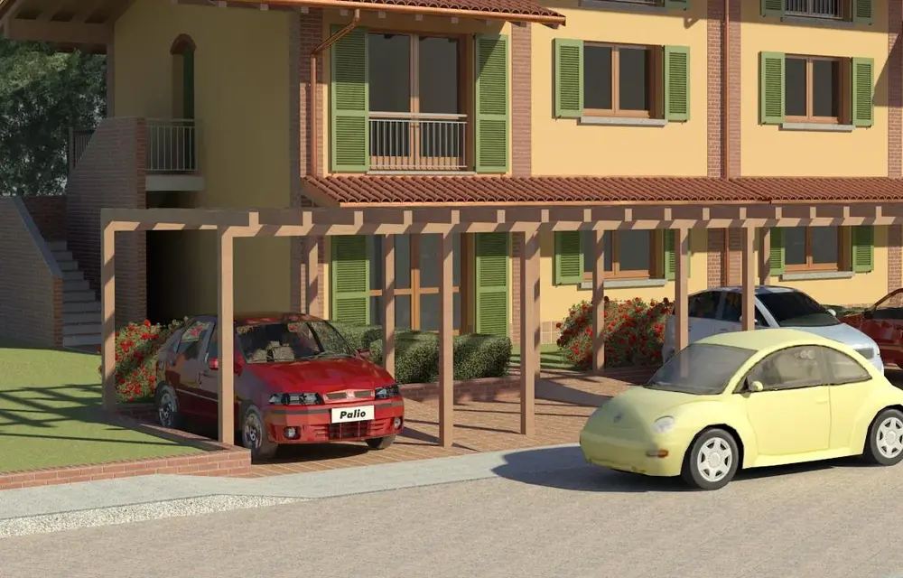

look that I too for an interior rendering with revit 2010 to the definition of 1920x1080
pixels with activated internal lights (18 between spotlights and lamps) and solar light entering from 2 windows with a quad xeon to 2.33 and 64-bit machine used us more than 4 hours
the same configuration for an external rendering with only sunlight no more than 10 minutes

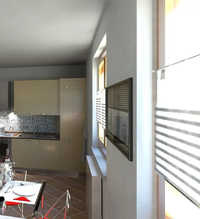

If you place pictures of what you are doing others can give you advice
However I think it depends on the fact that it is an interior rendering because I had tried only with sunlight turning off all the interior lights and time has not changed
for the paintings:www.allposters.it find any image you want, attach them to the wall as a decal and then put in front of a frame
for objects: many are wanted dwg on the internet mapped to layers in objects styles of imported categories
