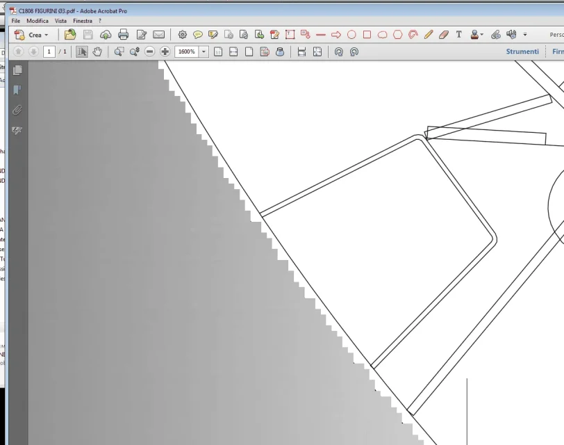

because if I use the gradient (2 colors) in a retino, then mold in pdf , if I look at the filling is all serrated?no nsi can 'obviate to this problem?

could depend on the quality settings of the pdf printer
What do you use?
I use adobe pdf
but I noticed that dwg to pdf autocad does it a better thread maybe it has some better algorithm, but the adobe does it better pdf.
Could it depend that you are looking at the pdf with a magnification ratio 1600 % (i.e. 16 times larger) ?
i.e. print and fill an a4 with a rectangle originally of 1,3x1.8 cm?
above all set the print resolution (quality=custom, you activate the dpi box and manual writing 600)
Ah ok sure maybe it is so certain if you do it on an a4 who sees it you say.
I tried to make custom with 600 dpi but nothing with pdf adobe sucks! if you do it with dwg to pdf is a better peline. I can't use the gradient at my point, but I'm sorry.
