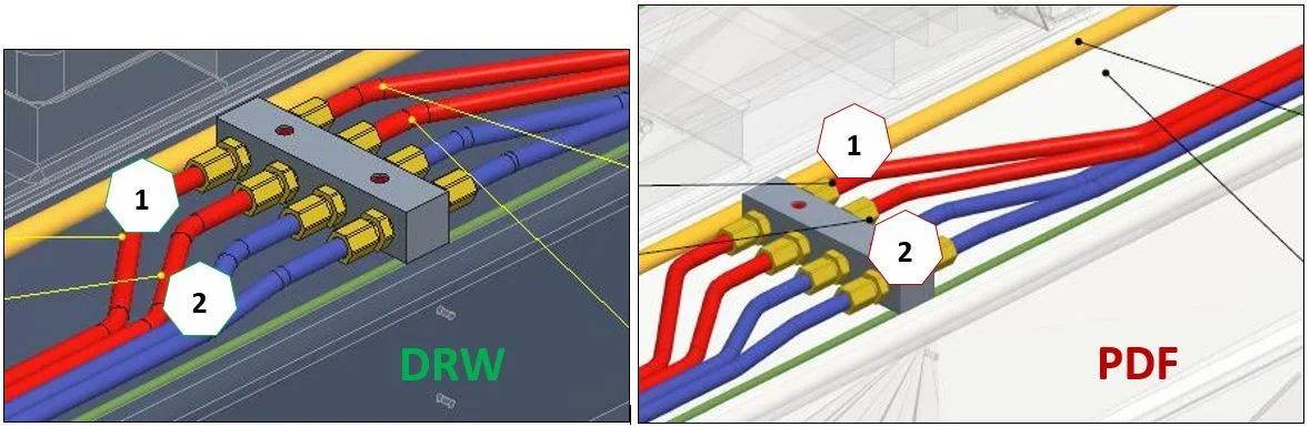

I created a dwr file, with inside the "colored" views, in order to better understand the installation of the departures and arrivals of some pipes.
export in pdf, activating coloring and increasing resolution to 600 dpi.
once generated the pdf, however, a view is incorrect, with the ball translating all the same size.Cattura.webpHas it happened yet?

I do not use drw, however try with This is External converter to see if it gives you the same problem.
Thanks for the tip, but I'd rather not upload a company file online for which I work.
I don't question the security of the site, but it would go against the company's policies.
It's correct, but you could reproduce the error by generating a simple generic design with the elements that create the problem and verify with that.
or by adding a component at a time and verify where the pdf is no longer created correctly.
This method I used it several times in the graphic field (adobe, corel, etc.).
Yes, I have often used this method to understand where mistakes were.
Usually, however, it happens to find hippo when you are at a 10% from the end, but at the beginning of the job.
This design, in particular, would take a long time to recover it from the beginning and pass through all the steps.
If I have time one day I will try.
In the meantime, I will give assistance to the operator during assembly.
thanks again for the support
also check the build marked by the mxxx code. It could be a kiss of what you have and possibly update it. the last available for creo 4 is m150.
