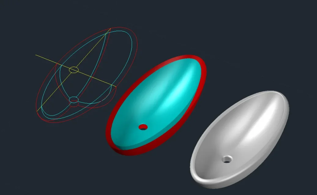

with autocad you can still manage the surfaces, but the impression is that it requires a work of Carthonians. I thought you were working more loosely. definitely has more tools than autocads regarding surfaces. I downloaded the demo to prove it.
