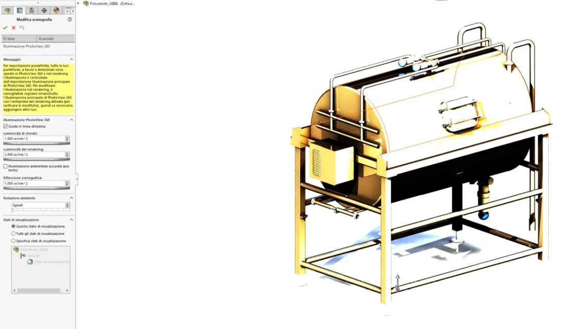

I am a designer at a small growing company, and I would like to propose a new site with the display of renders.
I started yesterday to cuff with photoview 360 and I didn't have big problems, but this morning at the opening of the file for a new render I find this problem that I can't fix.
from the image you can see that the steel finish of the machine is not correct, I increased the brightness both of the background and of the render because the base was all black.
I hope I have been quite clear in exposing the problem, in case I remain available for any clarification.

you can also change the brightness (as well as many other options), of every single aspect.
just go to the displaymanager (the colored ball you have on the top left)
if you like to cuff, try also visualize, of solidworks, a program to render (I made two small brochures where I worked before).
if you have the photoview 360, it is likely that you have a license that also includes visualize base (it will be basic, but still you do more things than with photoview)
Hello simone,
Thanks for the answer, I have already tried to change the settings but I can't get a natural view of the environment and the axieme.
I'm trying with visualize, but I'm struggling to set it up.
