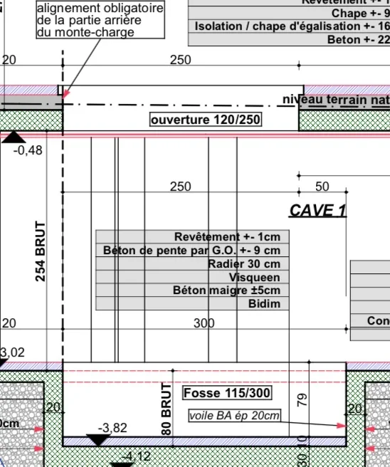

I am building a house and in order to better exploit the cellar (which is at -1) I made a hole in the floor of the garage.
The first job is to put a "plate" a few centimeters more wide and long than the garage hole. must be enough resistors to be able to support the machine (in theory the machine does not rest on the plate, but I prefer to go on the safe)
so when the hoist is closed in the cellar, the hole is closed by the plate.
what thickness would you make this famous plate? What kind of backup?
Thank you in advance.
alessandro
Maybe it's about doing a job for a professional. It's not a game. If you like you die and you do structural damage.
The cover described seems to resemble those used for inspection pits for sub-cock control in car repair shops, for example. there are specialized companies that build them, respecting the necessary standard security criteria.
to avoid harming people or things due to incorrect design, I would also address a professional in the industry.
Basically, you need a steel cover for the barrel.
find it already made from choose from a catalog, but given the size of the hole already defined by the specifications I do not think you will find the measure you need, unless you contact the foreign supplier (riga - Latvian) .
you can make it by a carpentry company oriented to civil constructions; for my part I can tell you two companies I know (zone bo - mo):
medium - light carpentry in the civil sector, see here;
medium light carpentry with predominance of the industrial sector but also realizes artefacts for civil, see here.
I think, however, that if you do a search for civil carpentry companies on the internet you can find also near your location, you will have to provide the hole size and the flow rate; consider that given the shape, size and positioning, the possible weight of the car will never affect entirely on the cover.
