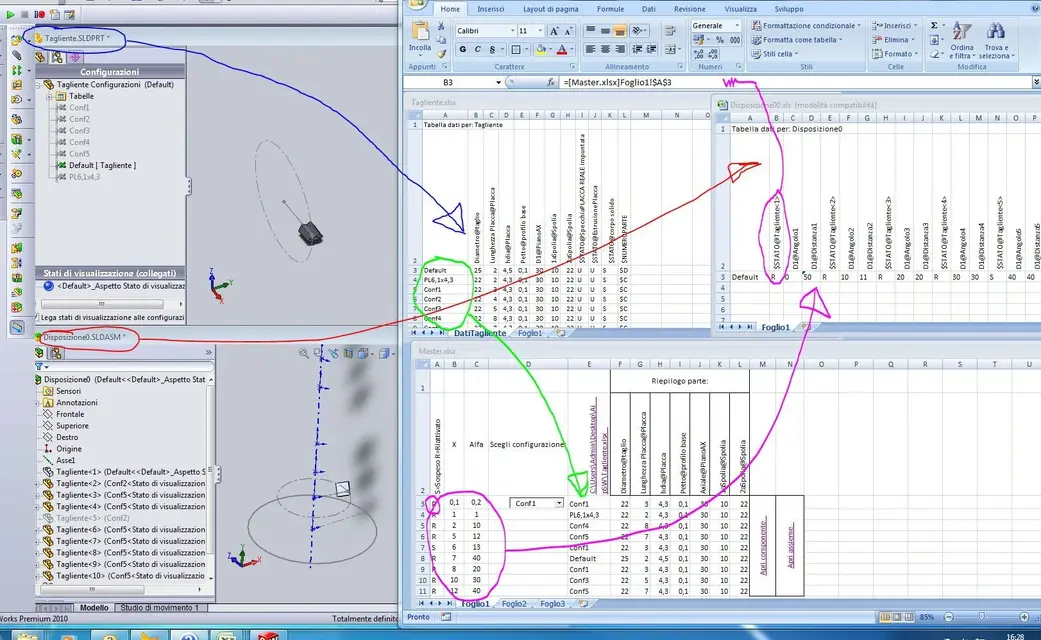

hi geppeto, I wanted to ask you if you ever used this method in practice. is extremely stable and functional in other cads, like the "different" that uses your brother, but in swx? I have often used the equations a little heavily repented and had to put a piece on it later. ...
I allow myself to provide my experience about the use of equations:
the products "simil-di serie" that we produce are born from some standard assemblies heavily structured with equations that connected together and parts.
this at the beginning (some time ago) because as soon as the assemblies become big slow and often in making "pack and go" equations lose references.
then we are modifying some models, always using equations but to control layout of assemblies on which to build the parts; avoiding as much direct links within the equations between both sides.
from what I understand you came to my conclusion, I just tested them.
