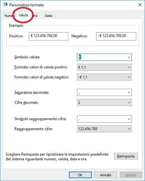

I ask you, for security... have you settled and/or checked only the part that indicates "numbers" or have you checked the part of the "currency"?
because the iproperty of the "preventive cost" is based on the currency and not on the only numbers.. . Valuta.webp
because the iproperty of the "preventive cost" is based on the currency and not on the only numbers.. . View attachment 45059
Yes, as I said I didn't look at the "currency." . .
Thank you so much.
