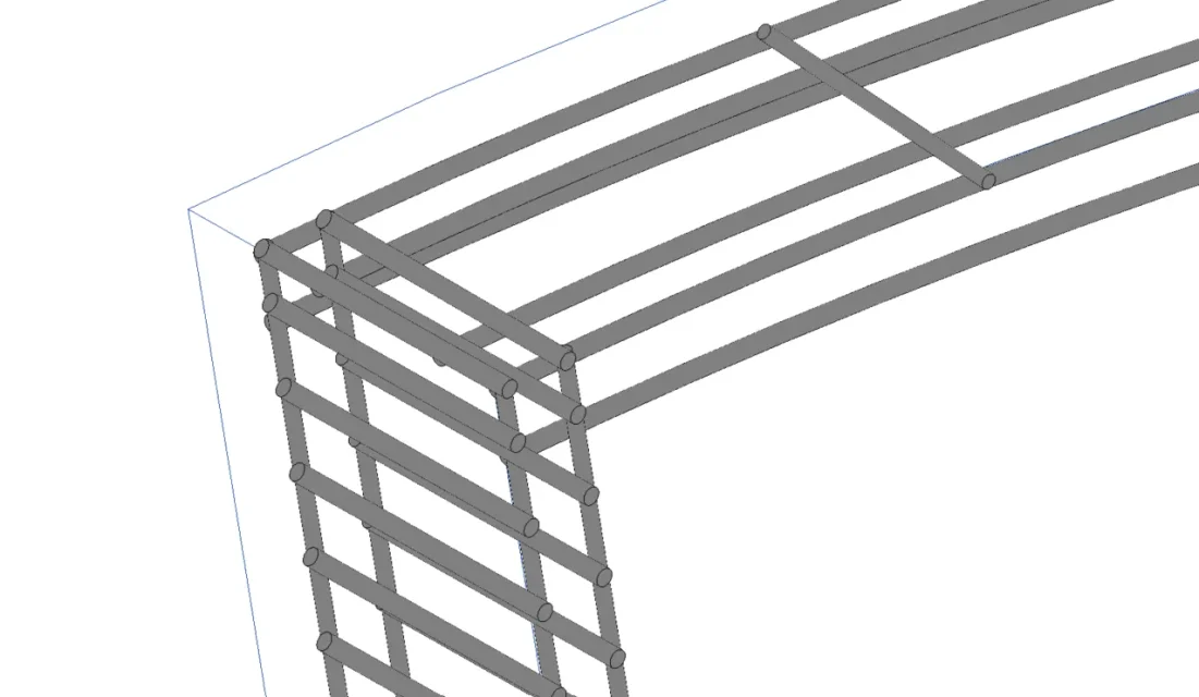

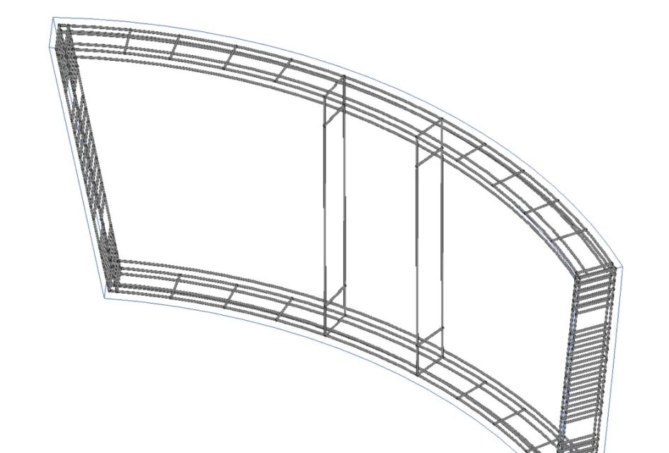

Good morning to all,
I am trying to apply the armor in a prefabricated (formerly modeled) cone typical of the tunnels dug with tbm. using the latest version of revit, after applying a generic cover, I managed to use the "free form rebar" command to create the geometry of the armor. Unfortunately, however, I cannot bind the individual bars to each other, but only to the shelter and referring to the host surface. Does anyone have any ideas?
Thank you in advance! !

the information of the types of constraints I read them, the problem is that with the armor in free form I can not bind the bars between them.
I'm not sure it's actually possible, but things have changed quickly with the latest versions. which release of revit are you using?
