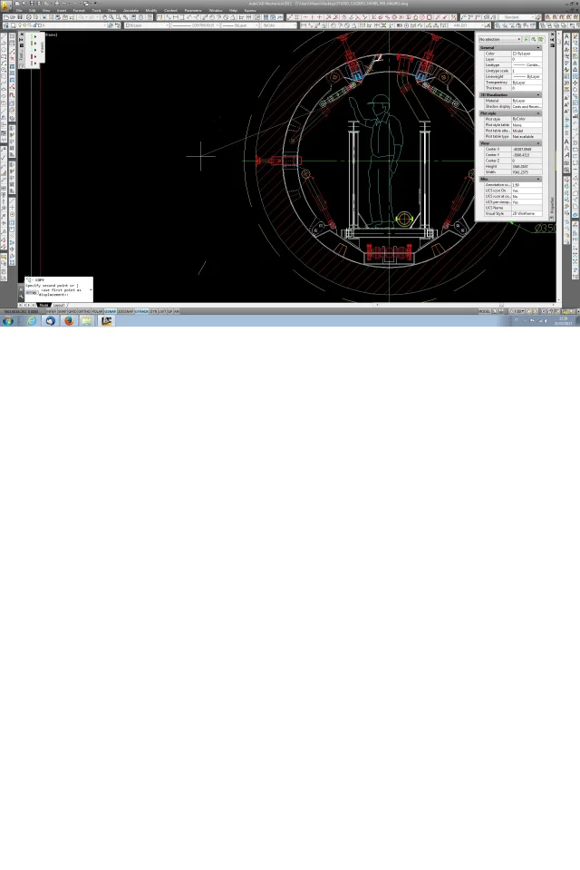

preview not available during moving objects

to me the preview does it with any thickness of polylinea.
I gamble a hypothesis... nvidia graphics card?
Could be. I also have nvidia and it makes me the same effect. But I realized now, after about ten years I work with autocad. Moreover if you move objects with criterion, references or distances, the preview does not need to see
I use a k2200 picture, the gifs are referred to the copy command, the command moves in the same way, only that the position original You just see.

I have a picture 2000, it might be that or an update of the drivers... or a system variable.. .

So... if needed, I managed to simulate the problem you encounter by deactivating hardware acceleration.
