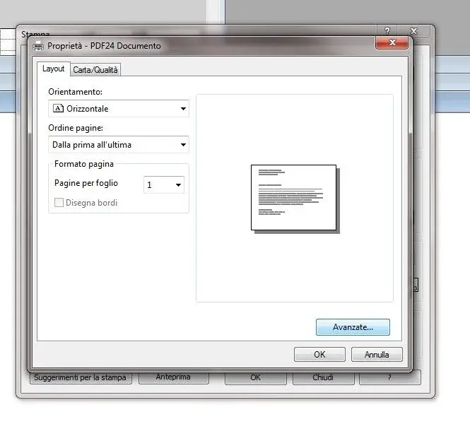

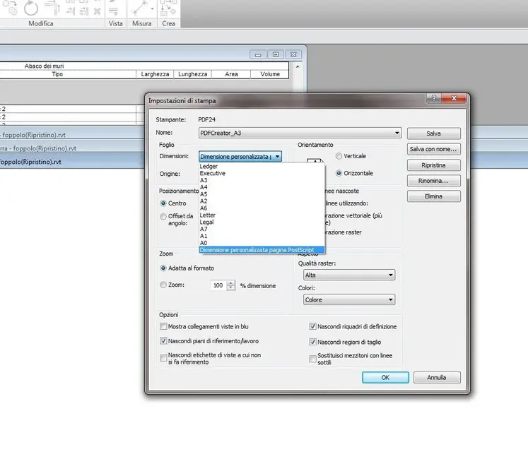

I don't know revit, but you can do tests using a virtual pdf printer and set up as the size of the "postscript" sheet so that the size of the sheet is required at the time of printing... at least don't throw the paper at all.
I'm trying to get you the big-line procedure.
After printing go to the printer property
and below

I hope to give a correct advice. . .
I created a family by setting the sheet measurements as "parameter instance" so when I insert the family to impaginate I put the measures I want.
