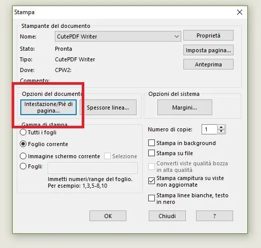

is it not that by chance someone knows how to automatically set up a footer for all prints that are made of parts, assemblies or tableware?
from the print interface of acad there is the possibility to insert various fields (file name, path, other ) in various points of the print/sheet area then enable it to pleasure or make it permanent, in sw someone knows if there is the possibility?

that works for the session in use, in the case of under assemblies, every time you open one the function must be reset and every time you charge a new solid same thing, if you then switch to the table of the components the music does not change. the option is fine to itself and if set is not part of the program options.... .

and setting it in the template works even if I mold drawings from other pcs? or better not being able to save a unique template (network work with other users , templates reside on the server and other users are a little octus.... ) can I copy templates on my pc so point to those prints?
I think yes, I just have to see how to do it quickly and painlessly, even if I have some doubts since the option is not selected, who knows. if you have any ideas or suggestions are well accepted, yes. Thank you. Hi.
I mean the prtdot, asmdot, drwdot files (which are the equivalent of autocad dwt)
if the file was created with the template in which header and footer were set yes, otherwise not.
just because the templates are on the server just update them once and so will always be used by everyone.
when you print it out of the open file, what does the template have to do with it?
I think so,
instead not, because if it was not already set in the template with which the file was created it will not do it later.
always kind and precise, tomorrow I try even if I think I understand that since the files were gendered without those features it will do nothing.
