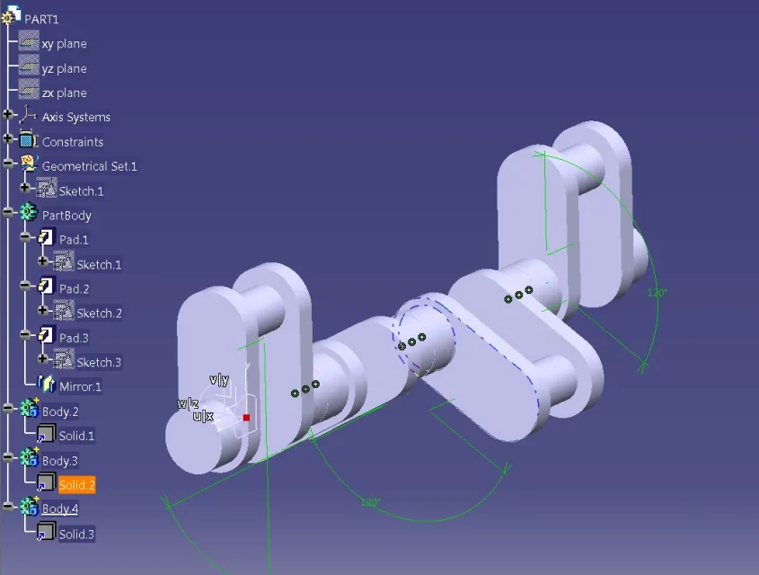

probably replicated geometry with file structure reconstruction.
if you run the paste copy with links you can tanquillously replicate the parts and use the 3d constraints for their positioning.
if you prefer the replica of the feature structure you need:
1 or I use power copy to replicate individual sectors
2 or I have used isolated axes tarts between them with constraints and replicate the geomatria.

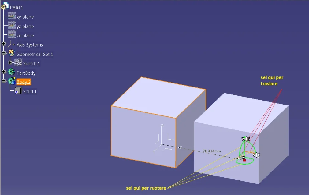

the problem is the transformation you applied.
if you apply the tasformation feature the model keeps in memory the spsosamente for which, or do it the appropriate step.
or transfer the volume using the compact, see photo.
drag the compass through the red point (1) on the element to be translated, when it becomes green (in case they were superimposed, once it has changed color select on the tree the body to be translated), you can translating the objects through the directions x or y or z see photo 2.
After the translation you can detach the compass by dragging it from the red point on the axle in the lower right (make sure that it is corrected as the orientation of the terna).
at this point you can use the 3d constraints.

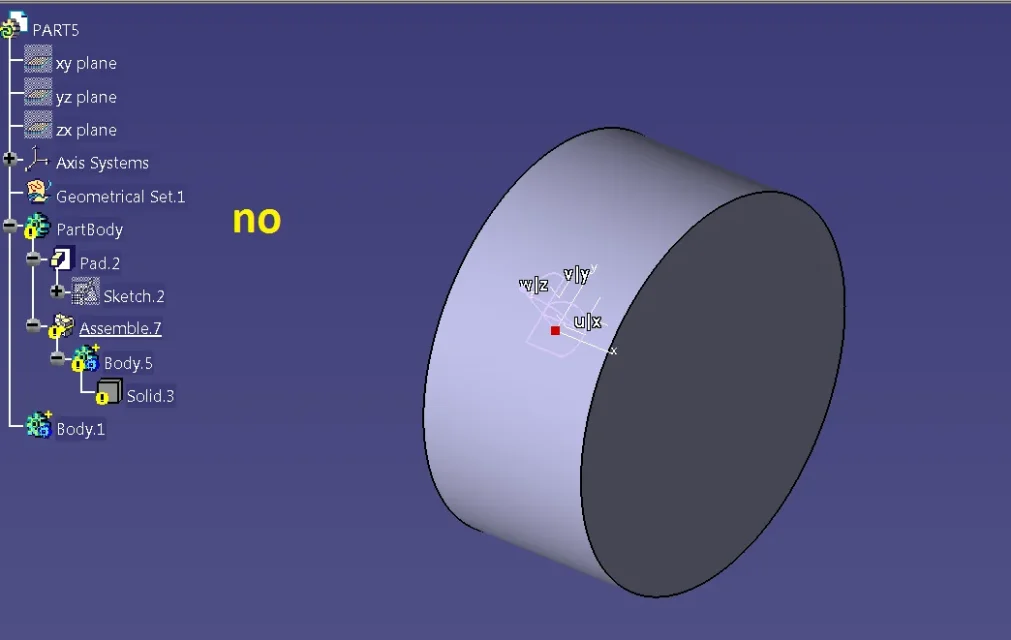

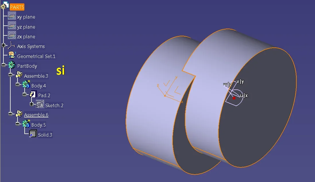

you are waxing to assemble a copy at a lower level than the copied object
see photos
in the curtain menu "insert" selection "aggingi un leotard" vacuum
buttondx on this, and in the curtain menu in the field "body object", select edit in "partbody".
At this point you can assemble all the body.

So I should copy the individual body....I did so: since between the single body and the part body there is a connection, I simply disabled this link....I clicked with the right button on the solid and in the last solid object voice I clicked on disable....so doing I managed to assemble everything...is it right or could I have combined something catastrophic? ? :smile:
ok I did as you recommended me and it actually works great....I don't know how to thank you.. .:finger:
