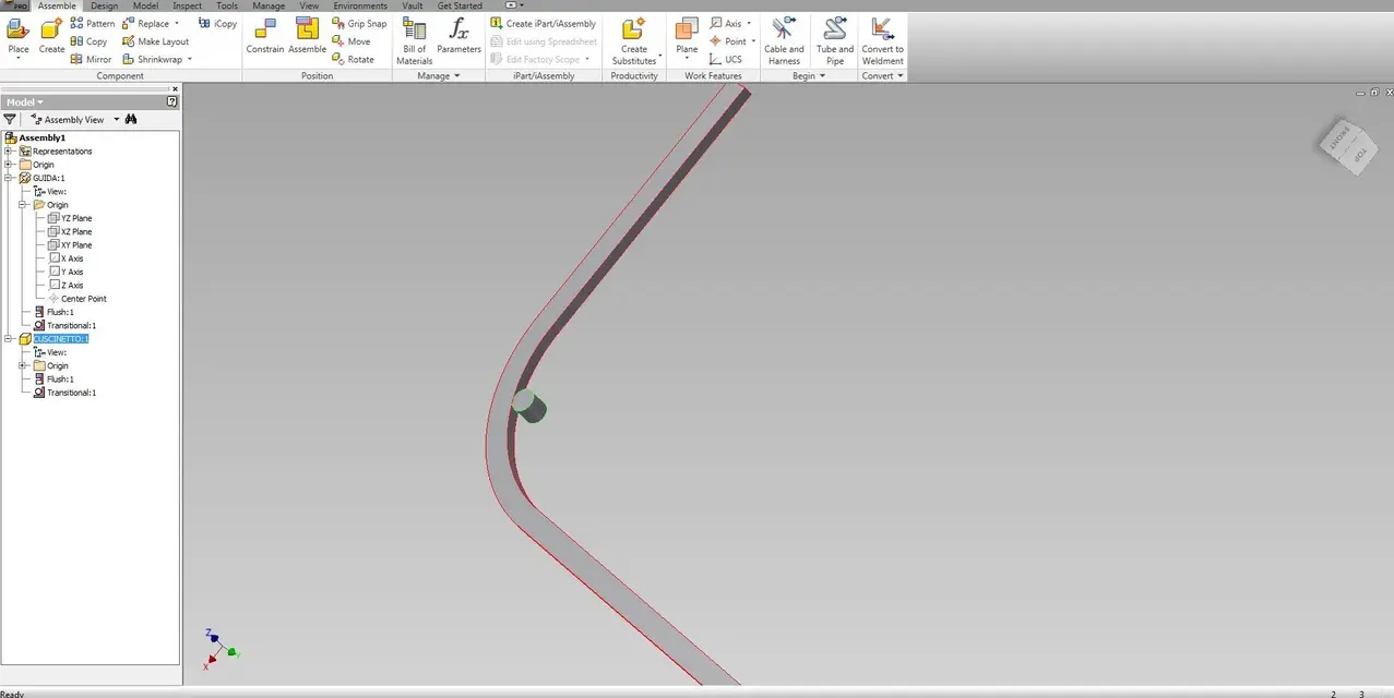

I have the following problem, I have to follow a cart with bearings, a track with curves and straight strokes, as I do.
Didn't happen to me?
Hello, try to connect the bearings to the surface of the track with the tangent bond
Yes you are, you must use the transitory bond. I apologize :rolleyes:
